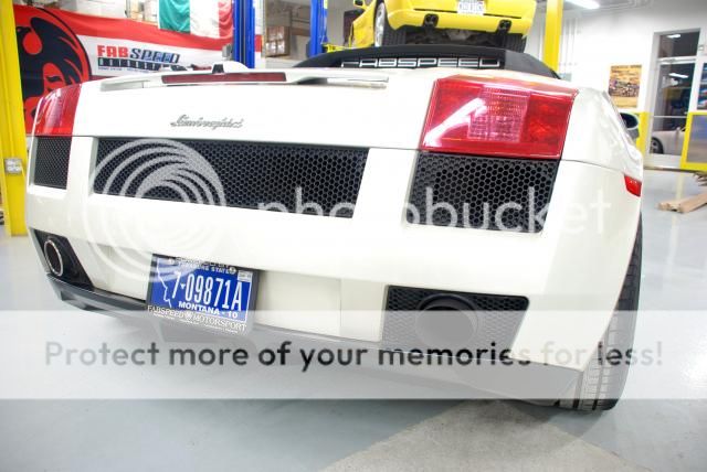

I went out for a cars and caffeine cruise this weekend and after a good long drive, someone noticed I had MELTED through the exhaust tip, the carbon dropped onto the bumper and melted a whole through the bumper:confused::confused: I really like the carbon fiber surrounds and tips, but man how could this of happened? I am not sure who made them as they were on the car???
Does anyone know if this is normal? or who makes these? the other side was super soft and seemed like the same was about to happen.

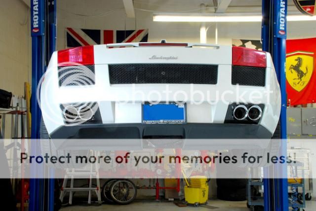

I have a set of OEM exhaust tips for sale, but they're dual tips from my 2009 LP560-4, I painted them with heat-resistant paint but they got scratched a little during removal. Easily touched up.
If you want something more permanent and resistant, you can always bring them to go get powder coated or ceramic coated.

The tip is very hard (obviously) the area around the whole and the other side where it's beginning to fail its soft to the touch much like just a woven piece of thread
