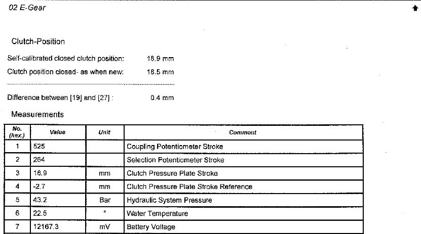

Can someone tell me what's the percentage left on my clutch?
Thanks in advance

Hi TwinV10 ,:wave:
Using the factory workshop manual recommended wear figure of 5.6 mm,
your clutch lining was worn 7.7% on purchase. Remaining life is 92.3%.
Previous owner either had near perfect e-gear shift technique or exceptional clutch lining.
Can you advise if your SL's clutch package is an OEM F clutch or aftermarket?
cheers,
john
#15 ·
I hate to be the bearer of bad news but it looks like you have 11% left, not 89% .
Your usage is at 5.1 mm. We have noticed about 90% of our customer's clutch is worn out by the time they hit 5.7 mm.
You have to be very careful when you have less than 20%. The snapshot is not super accurate. It's just an indication to give an approximate data. The difference between a cold clutch snapshot and a hot clutch snapshot can be as much as 0.5 mm.
A lot of our customers have told us when the clutch goes, it goes and they barely made it home. Try not to travel too far from home.
There is a test that you can do that puts a lot of loads on the clutch but only do this for testing once because it's not good for the engine or the clutch. Put it in the highest gear that the E-gear allows you(5th or 6th gear) and have a very low rpm 1200-1500 and 30-40 mph, then step on the throttle. If it slips then it means your clutch is at the end of its life.
Again sorry for giving you the bad news.
Thanks,
Sean

#17 ·
At 30k I had the PIS setting lowered, from 0096 to 0095, to make it
a bit more crisp / less soft, but that was the only thing that seemed
to make a difference w.r.t. the deterioration index. I am waiting for
my space/mile ratio to go above 1.5 at some point.
Could you elaborate more on this setting procedure because on the other day the dealer had mine fixed on PIS 0094, that's after three weeks of replacing a new clutch (with around 300 miles done on it)
Is that ok
Thanks
#18 ·
> Could you elaborate more on this setting procedure [...]
The procedure is trivial: plug in the Lamborghini diagnostic laptop
and select your desired PIS setting... and you are done. Then you
go drive around with the new setting to see if you want to keep it.
This takes a bit more than one trip around the block -- you really
want to go on a nice relaxed drive with all kinds of conditions. :)
As for technical details...
http://www.lamborghini-talk.com/vbforum/163422-post57.html
The default value is 96 hexadecimal = 150 decimal = 5.0 mm. So
every notch is 0.0333 mm. A lower value results in a biting point
at lower rpm (which makes it more harsh/crisp) whereas a higher
value results in a biting point at higher rpm (which makes it more
soft/smooth). The recommendation is to adjust the value in small
steps of no more than 3 notches at a time -- going one at a time
is really what you want... because if you can't feel that, then that
PIS setting isn't gonna make much of a difference to you anyway.
> [...] the other day the dealer had mine fixed on PIS 0094, that's
> miles done on it)
> Is that ok
The key when replacing an E-gear clutch is to reset the settings --
that is, make the car learn the "original position when closed" and
the "current position when closed" values for the fresh clutch disk.
Otherwise it will continue to use the settings for the old disk, which
will cause the new disk to wear out really quickly. (If it was even
drivable to begin with -- you should feel this mistake right away.)
Adjusting the PIS setting is separate -- it's really just a way to fine
tune the "match" between your car's clutch and your driving style.
You don't want to over-do the PIS adjustments of course; otherwise
you end up with too much bite (bucking... to the point of stalls), or
too little bite (slip... to the point of no-go), and wear rate will suck.
