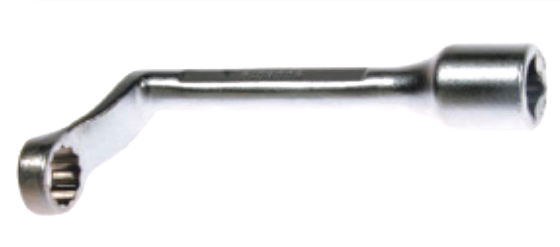

Take the correct size box end wrench and a socket extension to a weld shop and have them make one like the picture.

Do you mean one of these Steve?
