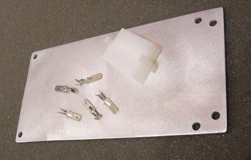

I just prepared a new box for a Jalpa:
The box on the left is for a Countach QV and will be installed on Saturday, another box went to Hamburg in Germany where another QV-Owner desparatly awaits it, since his MM is broken.
I can make an offer for the Jalpa Owner who want to install the MSD6 on their car.
I will sell the appropriate mounting plate, connector and instructions to wire the box for $50 plus shipment.
