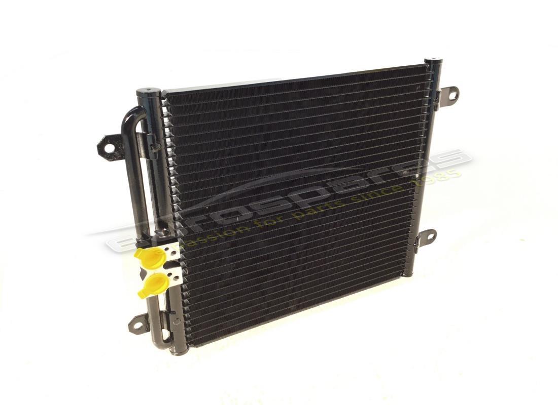

The plastic screens come on the STO (and possibly the Tecnica), but the AC condensers are the same for every trim of Huracan, so I just bought a pair for this purpose. They look like they simply snap onto the condensers.

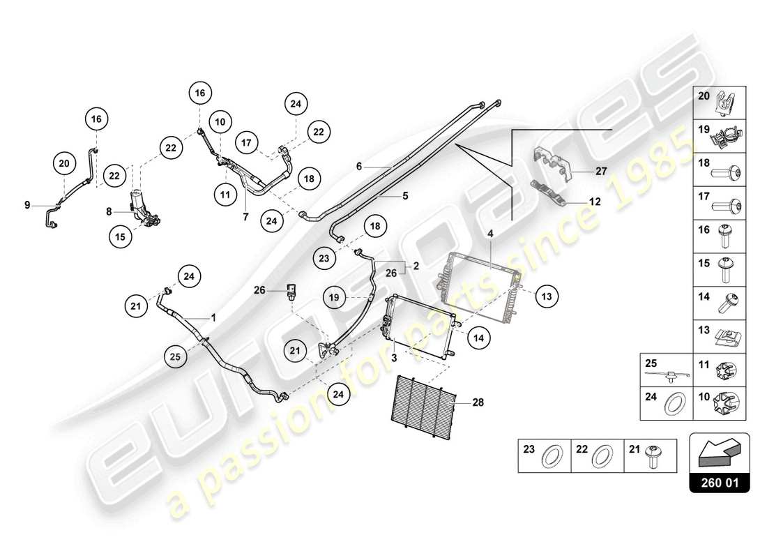

Here's the STO protector part:
And the AC condensers, that they affix to. As you can see, they are the same part number for every trim.
I actually have my new condensers, here at the house, so I can fit the protectors to them and snap some pics, before I drop the car off.
