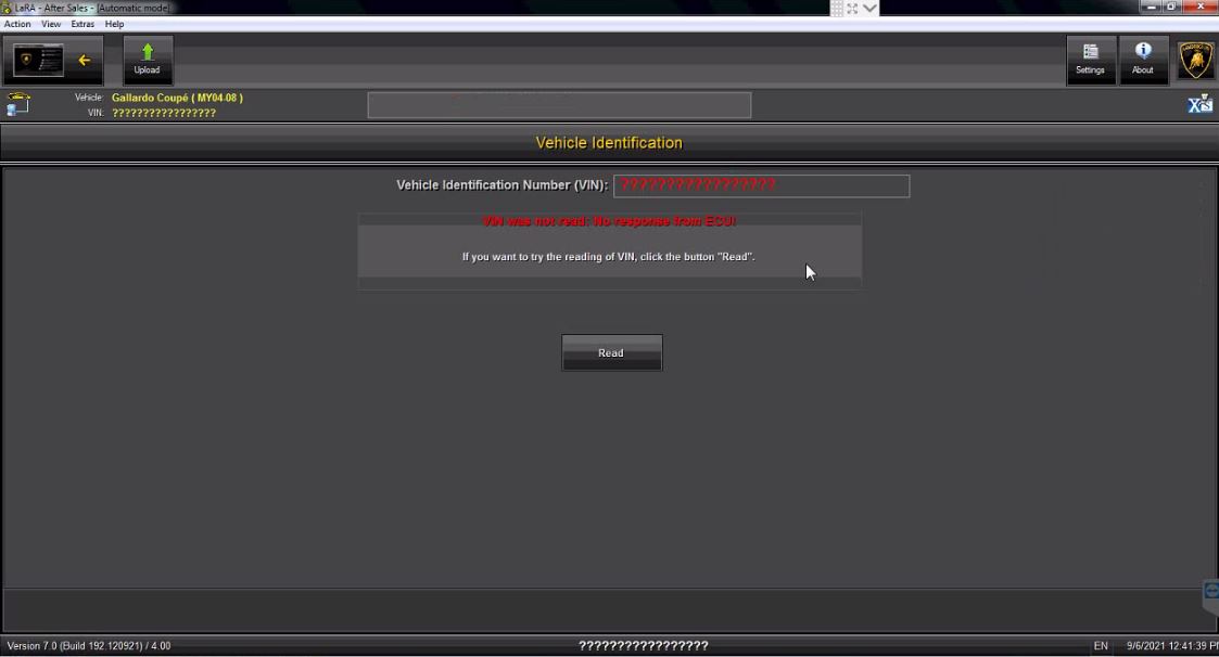

I have a Gallardo 2006, but the Lara 7.0 just install can not connect to the car

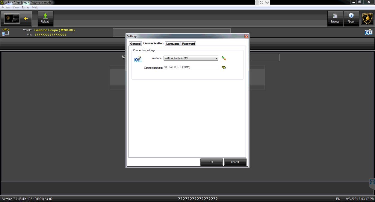

I use Actia Basic XS + cable OBD 2, both are original
the software Lara 7.0, just installed

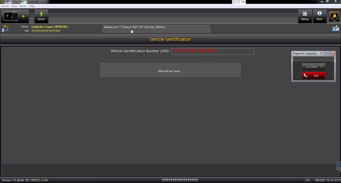

When connect, it show: "initialising interface OK", then: Address word 17, Protocol KWP1281, Baud rate 9600 bps
And then: No response from ECU
I use Maxisys MS908S Pro, read by OBD 2 and can connect, read VIN exactly, so the problem not by a car
Anyone meet this problem please help me
Many thanks

Hello, i have this problem, i don't know if its the interface herself got à trouble.
Do you uprade your firmware?
Do you modify the pinout on the obd2 cable?
My problem to mine is: i can't upgrade the firmware, i don't know what to do more.
