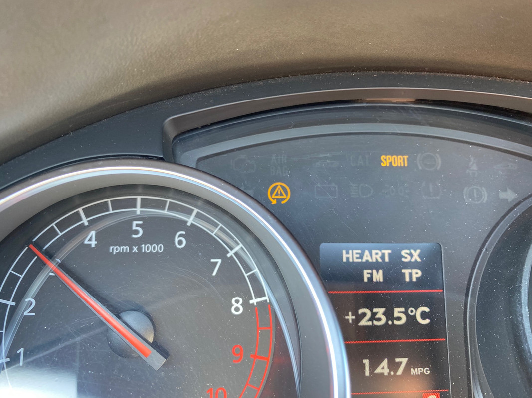

Hi all,
I have a 07 Gallardo Spyder and recently the following light has intermittently been coming up on the dash when driving. If I stop the car, keys out and start again it stays off but sometimes will come back on again. I think its something to do with the traction control / steering? I have plugged a fault code reader in and nothing appears. The only other thing I have noticed that may be completely un-related is that the steering wheel has a bit of movement in it before I can feel the wheels turning (as in turn slightly to left or right, feels kinda loose), not sure if this is a characteristic of the car as I have not long owned it and came out of a 3 year old S63 coupe. I've tried various sequences to see if I can trigger it but no luck.
Note it did have new 'steering gear' fitted by Lamborghini in September 2018, about 1000 miles ago.
Can anyone offer some advice / pointers?
Thanks

Dont' worry : It's ESP off.
I Always drive this way : ESP off and Sport mode :)
To Switch it on or off just push for 3 seconds the ESF button.
See the pic (it's not my car but it's here).

I don't think it will be that as it switches itself on intermittently? Speed sensor/ABS sensor related?

Mine currently is showing the Stability control and ABS. I just a few minutes ago tried to read the code with a Bluedriver reader but it didn't pull the codes.
I figure mine is a wheel speed sensor or a wire to the sensor since sometimes it does work fine with no lights. I just need a way to know which wheel it is.
Yours with no ABS like mine on would mean yours isn't a wheel speed sensor. It could be a steering position sensor, especially if it has had the steering replaced they might have messed up a sensor or the wires. If you already have slack in the steering that isn't good. My car has over 63k miles and no slack in the steering.

Ok thanks, with the slack i just get a bit of play before I feel the wheels turning, not sure if its good or bad, surely if the steering gear was replaced it would have been sorted or worst still not put back together correctly? Are their any guides to check this over that you are aware of or is it main dealer only?
Like yours it flickered once but comes on so intermittently it could be a faulty wire. Do I not have ABS then?

You may still have ABS since the light isn't on, to me that would rule out a wheel speed sensor. Did you get some type of warranty with the repair? I would at least call them and explain the situation. There should not be any slack the system and slack could throw off the steering sensor.
