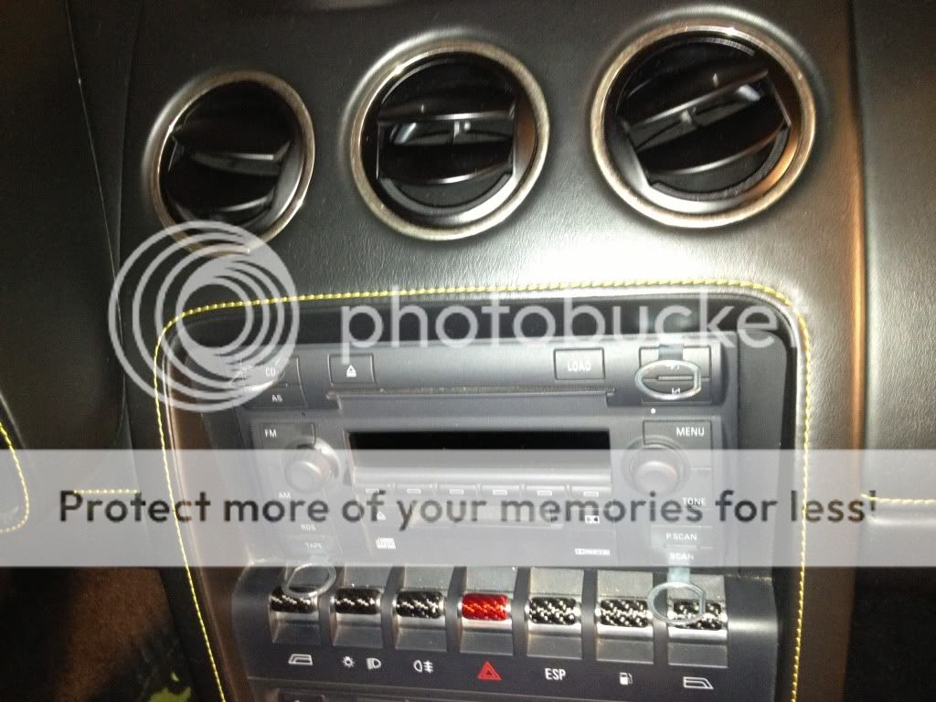

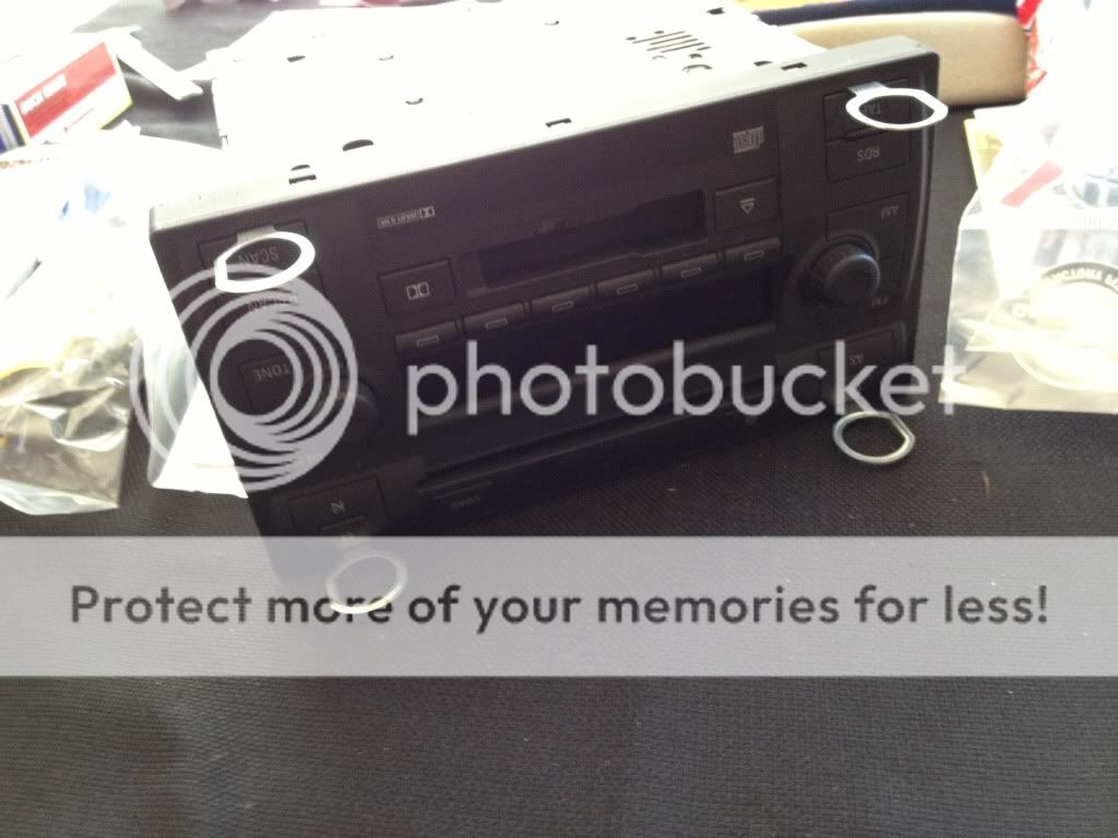

You will need four Audi removal tools. And with the harness you buy for that audi, it will have two harness. As I found out later, with much work and research, you will only use one of those harnesses.
With those audi removal tools, they kept slipping out of the slots when I tried to pull the radio out. I found out, after pulling the radio out by partially disassembling the dash, that if you put a small downward bend in the tools, they were more likely to stay in the radio and letting you pull it out.
The curved side of the tool goes towards the middle of the radio. When you pull on those tool/tabs, the radio will, not easily for me, come out.

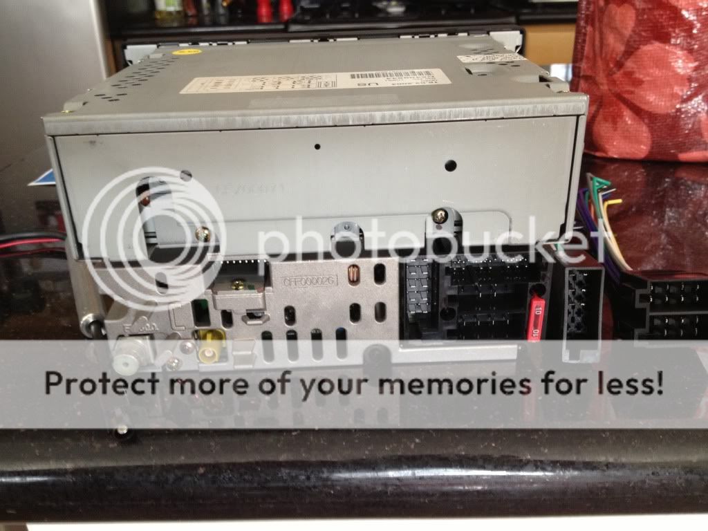

You will see that the back of the radio has three harnesses. One is for the CAN system directly(the top one), the other has the speaker outputs, and the other has the power wires. NOTE that there is no ignition or illumination wire on ANY of these harnesses. There are other wires that were completely undecipherable to me. I assume they somehow interact with the CAN system.
Also of BIG NOTE, there are TWO antenna hook ups to the Symphony II.

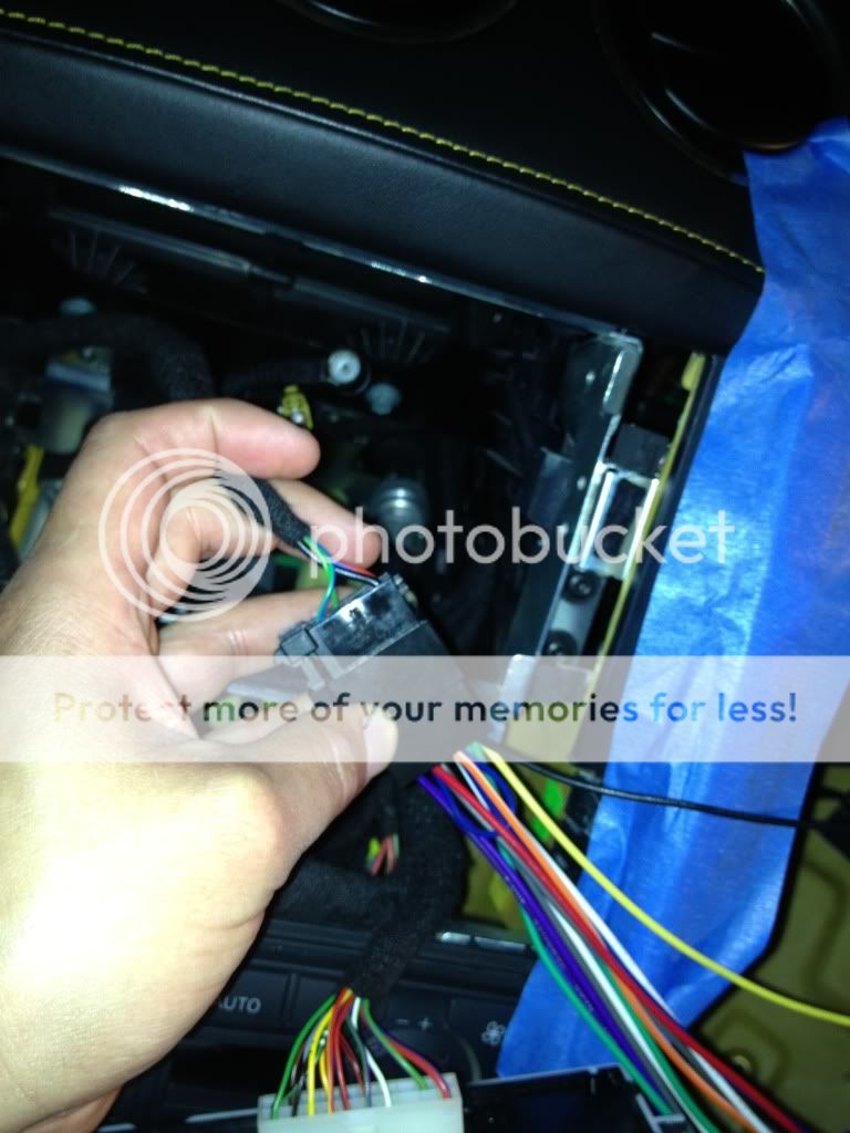

There were many wires that could not be used in the aftermarket harness I bought. To name a few, there is no power antenna, ign, illum, rear speakers, steering wheel, etc...
I didn't want a bunch of loose wires so I removed the tabs from the harness I wouldn't use.

I found my ignition wire here, in one of the harnesses to the window switches:
As I wanted an illumination wire as well, so I don't get blinded at night, I went off of the right rear side marker. I tapped this wire before to put LED lights in my engine compartment. As I'm adding a rearview camera, I was already in that vicinity.
Labeling is nice incase I ever have to go back in and change something.
