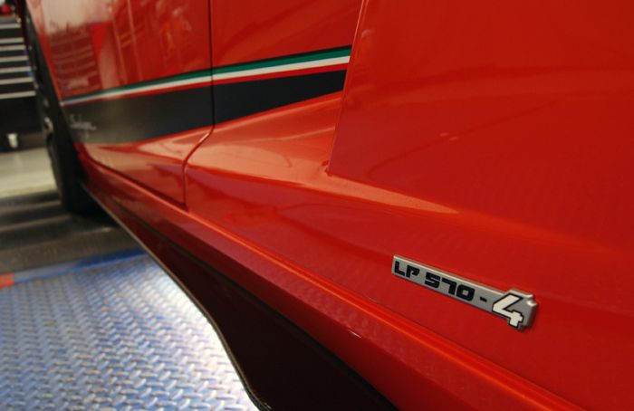

This particular Edizione Technica Superleggera was featured in our VF760 brochure recently along with another black 2013 LP570 Supercharged SL.
The car was brought directly to our facility from Lamborghini Newport Beach with only 50 miles on the ODO. This is the owner's 2nd VF supercharged Gallardo.

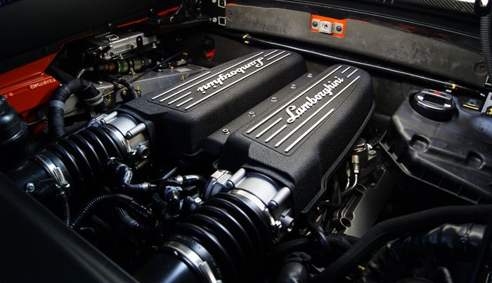

Out with the OEM.
Because the kit is 100% bolt-on, the motor does not need to removed to install the supercharger.
Twin Front-mounted radiators and Air-to-water cooling system up next...

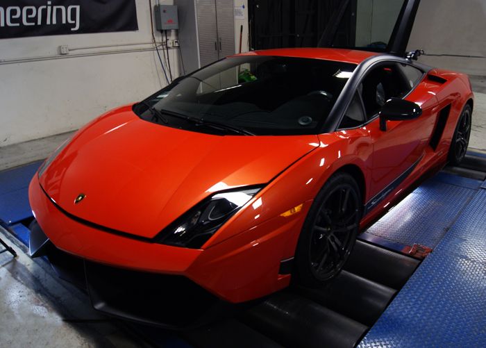

Discussion Starter · #13 · (Edited)
Teaser shot from our soon-to-be released video of this car :)
