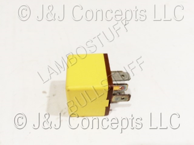

Any cross reference on these murcielago relays ? Located on passenger side floorboard.

I am sure those can be cross referenced pretty easily even though I don't have part numbers for you. If nothing else, the local VW dealer parts counter should have them, but the regular parts store should have them too. Nothing unusual there, just regular 12V auto relays that should be easy to match up.
Do you know they are bad for sure, or just shooting in the dark as a troubleshooting step? I bet some parts store have relay testers that will check for free, but you can do the time honored tradition of swapping them with known good ones from other circuits in your car for a quick test. Or you can get fancy and buy your own tester for $16:

I have the 12V tester and the two yellow relays are bad.
The brown 205 tested GOOD - green light after 10 clicks.
Lambo Stuff has (1) one left - and I need (2) two.
8 0061010037 MINI RELAIS
MINI-RELAY BITRON 23102
2 req $40.01Add To Cart Add Current Stock: 1
Thanks - I will try to find - cross reference replacements.
